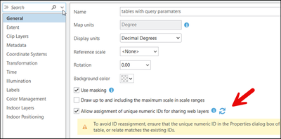

I think it would be helpful to have a button next to the current setting for unique IDs that resets the number count of unique IDs for layers in a map in a top to bottom order. That way if you need to redo the unique IDs while developing a new service you can just hit a button instead of opening every layer and manually updating them. It would probably be a good idea to have a confirmation box popup to confirm the action.

This reset option was introduced in ArcGIS Pro 3.6. Can you pls try and let us know? Please note that this action is undo/redo-able, so that if you make some changes by accident, you can roll it back

It looks like the what is in your screenshot is what I had in mind and I would rather have the undo/redo than a confirmation box now that you mention it.
