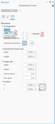

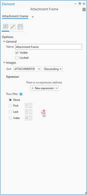

These features have been implemented in Pro 3.7. Now when you add an attachment frame, the Element pane has a few options for you
1. Designate which attachments to export, first x, last x, index, or all (default is all)
2. Grid orientation or one per page
3. Dynamic row option to show all attachments on export
