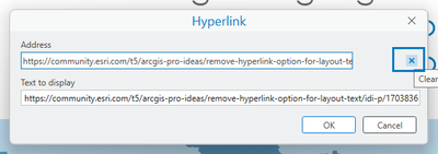

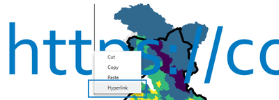

If you right click with your cursor within the hyperlink you get a text only context menu that includes a Hyperlink option. This opens the hyperlink editor and you can click on the X to remove the hyperlink altogether.

Hey @AubriOtis thanks for commenting and for implementing this feature! What version is that live in? I just checked 3.6.1 and didn't see it.
AubriOtis
I was testing in 3.7, but it was implemented with the original hyperlinks, so you should see it. You do have to have your cursor within the hyperlink. Otherwise you get the element context menu which is generic and doesn't include the hyperlink functionality.
BrettFrahm
@AubriOtis Aw yep, I see it now. I always edit text in the element pane, so I would have never found that. Also the tag I needed I guess was  <NOLINK>, which I couldn't figure out either.
