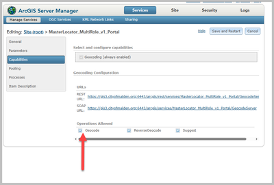

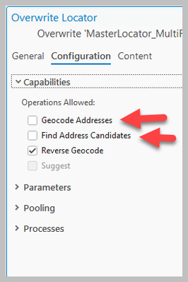

Everytime we rebuild a locator we now need open the configuration tab and click on Geocode Addresses and Find Address Candidates.
