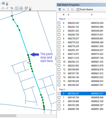

Multipart features get created by accident. The person who created the features merged two lines together, but didn't realize that a multipart feature was created.
Or, in some cases, multi-part features get created on purpose. We don't want that either.
There ought to be an optional setting in a feature class's properties for preventing multi-parts from being created. Currently, I don't think that functionality exists.
I imagine it would be possible to disallow multiparts using an attribute rule. But at this point, we've got so many attribute rules in the works that we're terrified that we're creating a monster. We'd much rather there be OOTB functionality for this stuff. (Similarly, we want to prevent true curves via a FC property too.)

The multiparts were created manually in an existing FC.
Here's an explanation from a related post:
Multipart features were created manually...by accident. The person who digitized the roads merged two lines together, but didn't realize that a multipart feature was created.
We want to prevent our users from manually creating multipart features.

Multi-part lines will be the end of me. They cause problems every time I try to do something.
Yes, eventually we'll undertake several large projects to get rid of multipart features in all of our FCs. And deal with the fallout in all of our dependent/related FCs and tables. But that will take a lot of time.
And then afterwards, once our organization has fully switched to a modern version of Pro, we'll prevent multiparts going forward using attribute rules. But as mentioned, we'd prefer it if preventing multiparts were an OOTB FC property, not a customization.
In the meantime, multiparts make analysis unnecessarily difficult.
