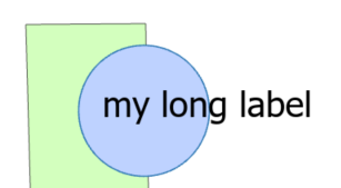

You can use the Allow Asymmetric Overrun parameter to have the label extend to one side of a feature when it has a higher weighted feature to the other side.
In the example below I weighted the green polygon at 700 and that forced the label to extend to the empty space to the right.
Read more about it in the Allow labels to overrun a feature documentation
