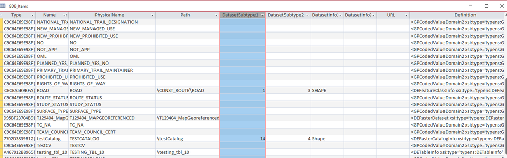

Not sure about what the 8.x ones looked like (never found one to crack open and test, please send me one if you have one) but 9.x had a different schema. Still usable and retrievable with knowhow, but it was set up differently.
For example, 10.x used the GDB_Items table to list everything, and the Definition Field used XML(?) to determine what type of object it was. (You could also look at DatasetSubtype1 and DatasetSubtype2, but I've never had to for what I was looking for.) The GDB_Items table include Mosaics, feature classes, raster catalogs, feature datasets, domains, etc. You could look at the Path field to tell if something was in a feature dataset.

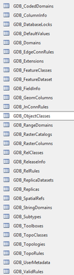

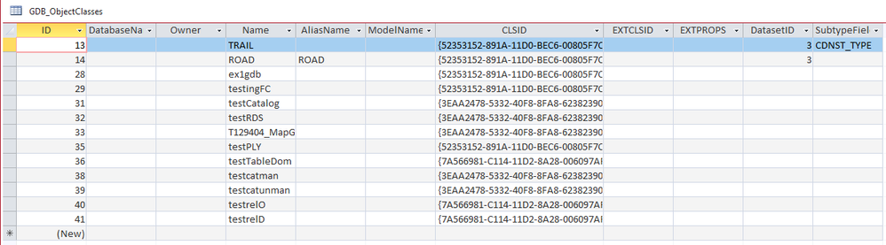

In contrast, the 9.x used the GDB_ObjectClasses table to list everything, but it gave really no details otherwise. It mentions if a feature class is in a feature dataset, for example, but doesn't actually tell you which one that is.
Instead, you have to go to each table for each object type and investigate.

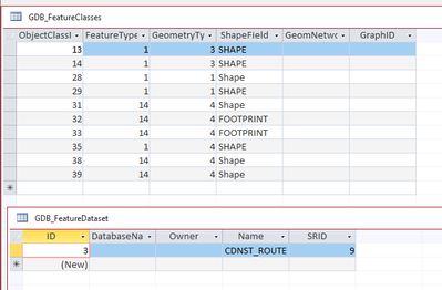

Once there, you still don't have any details on the feature class, although you'll notice that FeatureType and GeometryType match with the DataSubtype1 and DataSubtype2 fields in 10.x
To be honest, I can't remember how to find the spatial reference in 9.X for each table. You can find it pretty easily for Feature Datasets (SRID field has the objectid for the matching spatial reference in the spatial reference table) but Idk about the tables themselves.
