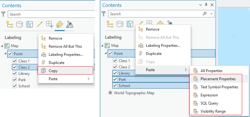

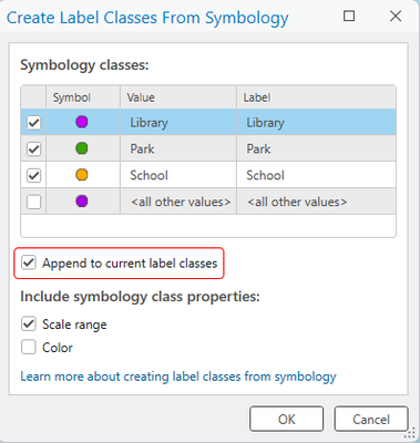

What I do in this case is check the Append to current label classes box to preserve my existing label classes that I've already configured.
Then once the new label classes have been added, I copy and paste label class properties to the new label classes:
1. Change the Contents pane to list by labeling to view all the label classes.
2. Right-click the label class with the preconfigured properties.
3. Select one or more of the new label classes, right-click and choose Paste > and then select any of the sub-sets of properties to paste. Don't paste All properties or you'll overwrite the SQL Query that was created when the new label classes were imported.
