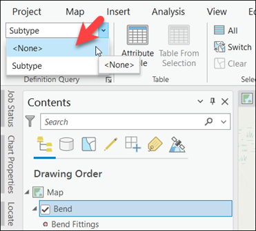

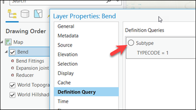

ArcGIS Pro supports that already. All you need to do is click on the check box to de-activate your def query.
or, you can do it from the ribbon UI too
