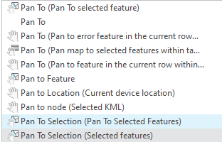

3.  In the Search box, type pan to
4.  Of the 12 items filtered by pan to, I chose the 11th one - Pan to Selection (Selected features).
5.  Click the Add-> button and then click OK
In ArcGIS Pro, you can select a feature or features in a map.  The layer in the Contents Pane must also be selected.  The newly added button on the Quick Access toolbar will be "on" - click that and the map pans to the selected features at the same scale as it was before.  There are other pan to commands that work in attribute tables as well.

Thanks for the response, Robert.
I tested all 10 currently available to me in ver 3.3, and,  unfortunately, all of them require a selection or are context-specific such as a topology error or device location, etc.
This request is to move the camera while maintaining scale, without having a selection active, and currently none of the offerings available fulfill that need.
