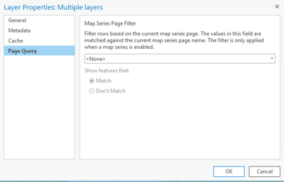

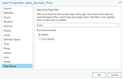

This is the selection of one with carte as the field filter.

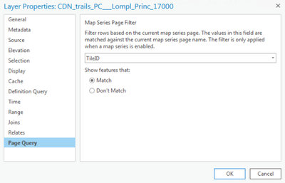

This is the field generated when using tiled label 
This is the filter with multiple selections, where I point to TileId forgotten that I have in the selection Carte for one layer.  In this layer, no field is label TileId.  I think it's why it's take forever to process because it can't find the right field in one layer. So, a warning pop-up could be appreciated.
