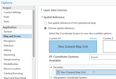

Hello @Michele_Hosking , this is what I see in ArcGIS Pro 3.3.2. I have set my Options > Map & Scene > Spatial Reference, set to "Choose spatial reference", and I selected New Zealand Map Grid.
Then in ArcGIS Pro, I Insert > New Map, which adds an empty Map that has Current XY set to New Zealand Map Grid, as expected.

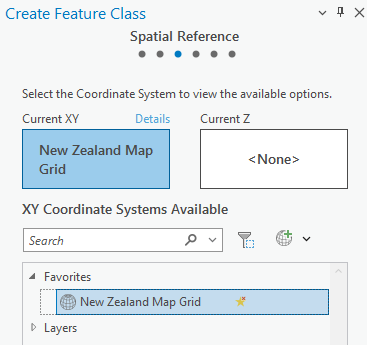

And when I use Catalog > right-click on database >, New > Feature Class > set any Name > Next > Next, Current XY is already set to New Zealand Map Grid for me.
And if you Save your Project like that, it will use New Zealand Map Grid next time too.
