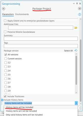

@MattWilkie1 Thank you for submitting this idea. The Package Project geoprocessing tool has an "Include History Items" parameter. Does the "History items will be included" option meet your requirement?
MattWilkie1
No, because packaging will refuse to progress if the history has errors (https://community.esri.com/t5/arcgis-pro-questions/packaging-error-00246-history-items-with-errors/m...). This idea is to (optionally) allow packaging even if there are errors.
JonahLay
@MattWilkie1 Thanks for the response. The Package Project sharing pane does not currently support creating packages with errors. We will look into adding support for this.
As a workaround for the time being, can you try using the Package Project geoprocessing tool to package your project? Please see the screenshot below:
MattWilkie1
Thanks for looking into adding support for this option @JonahLay
And also thanks for pointing out there two* different methods to Package Project, and yes for the problem project which sparked this post, the gp tool works and the ribbon tool does not.
