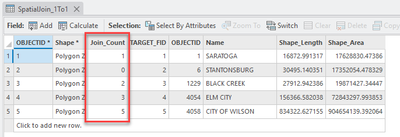

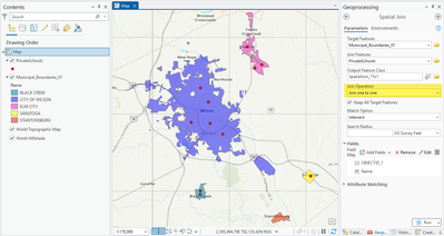

Hello @Bud, I am not sure what output  you would like but to get the number of "ridings there are per municipality" you could try using a 1-to-1 join operation instead.
here I made 2 feature classes: municipal boundaries and schools. Then in the Spatial Join tool, I used the municipal boundaries as the target feature and schools as the join feature, and set the join operation to one-to-one
The output's join_count field includes a count of all the schools per municipality.
-Margaret

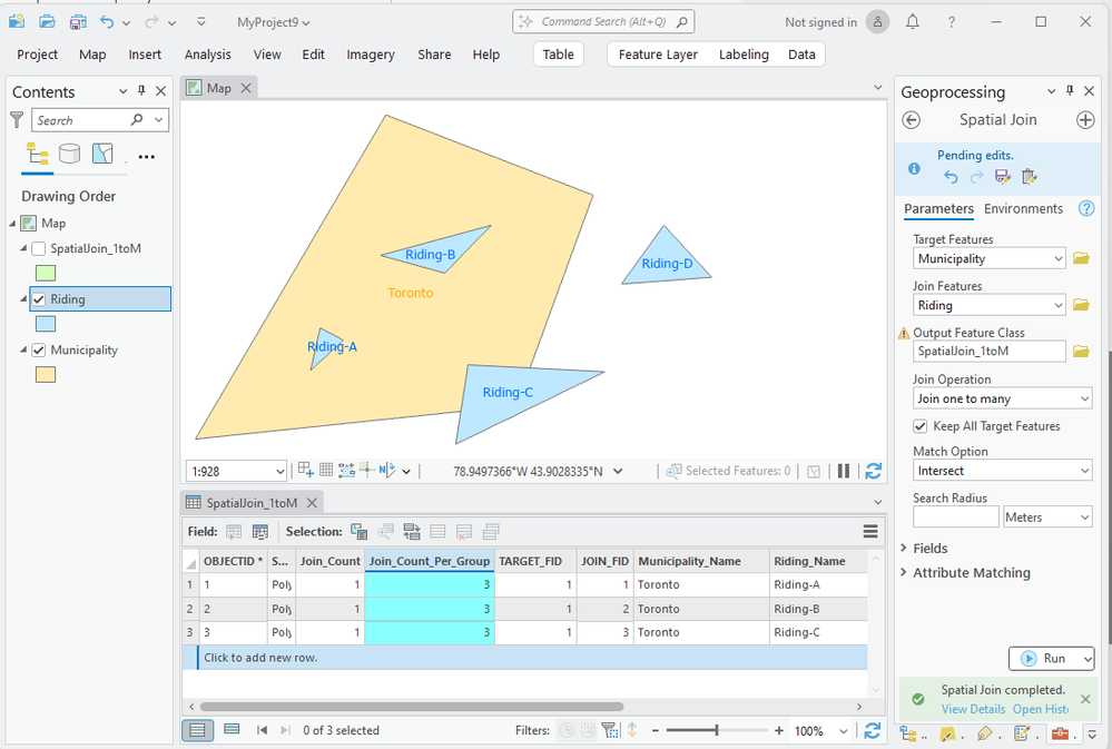

Here's a screenshot of what I'm looking for. I manually created the Join_Count_Per_Group field after the fact to show what I want.
Use Case: I want a list of municipalities and the ridings that touch the municipalities. I want one row per riding/municipality combination, hence the one to many join. And I want to only include rows where there is more than one riding per municipality, by creating a definition query:  Join_Count_Per_Group > 1. I want to do this using a single geoprocessing tool.
