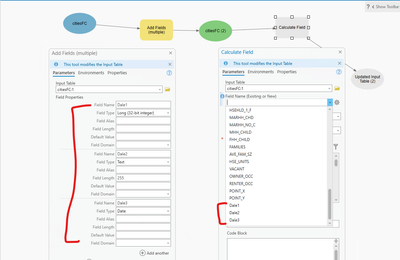

  • Create a new model
  • Add data that has a table.  (Don't worry, you won't execute any tools)
  • Add the 'Add Fields (multiple)' tool and make the data the input table
  • Create a couple of new fields (again, don't execute)
  • Connect Calculate Field to the output of Add Fields and open Calculate Field
  • The fields you added with Add Fields don't appear in the list of fields to calculate.  They should -- that's the behavior of Add Field.
Add Fields isn't updating its output data element with the new fields.
UPDATE: I wasn't able to reproduce this after closing & reopening project, or trying this in other projects.  User error?

GeeteshSingh07
Hi @Dale_Honeycutt, I wonder which version of ArcGIS Pro you are using?
I could see my fields in 'FieldName' section:
Dale_Honeycutt
Wow - I'm using Pro 3.2.2
I'll try this in a couple of other projects and inputs.
It was definitely reproduceable in the project I was working on.
Dale_Honeycutt
I'm seeing the fields now - different project, different input.
Don't know what could have caused this -- I'm beginning to think its user error.
Thank you for investigating.
