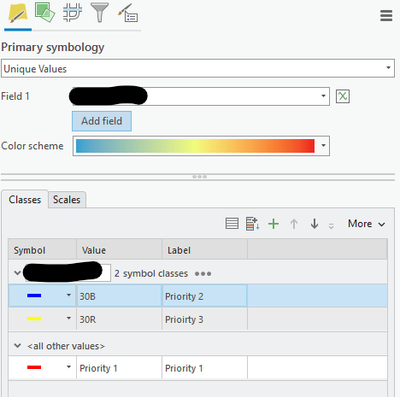

Pretty small request here. Just looking for the ability to move the all other values symbol up and down in the legend like we are already able to do with other symbols. I know that I have the ability to convert the legend to graphics and re-arrange but I would like to keep the connection between the legend and map layers in case I have to add more data to my layout down the road. In my screen capture below, I want the Priority 1 symbol & label to appear first in my map layout to stay consistent with other maps in this series even though none of these features appear in the map.

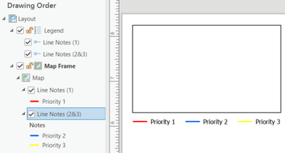

JesseWickizer
@SarahRijneke, as a workaround, you could split your priority 2 & 3 values and the other values into separate layers with definition queries, then add the 2 layers to the legend in the desired order.
This way avoids converting the legend to graphics, maintaining connection to each layers' symbology.

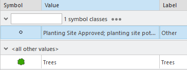

I was looking for a way to reorder All Other Values in Pro, around my other Unique Values.  I have a handful of tree stumps and other non-trees grouped into one category called Other, and the rest of the trees in this FC are "all other values" - labeled as Trees.  It would be great to have my Trees (All other values) at the top of the list, and my Others category at the bottom... but can't mix/swap the two. 😞
