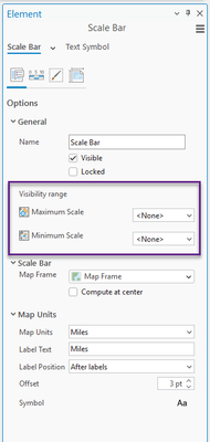

Have you tried using visibility ranges, which are currently available, to help with this?
We added these to help with a map series, so you can create scale bars optimized for specific scale ranges. You have to create multiple scale bars, but with the proper scale ranges, only one scale bar will show per map. It gives you a lot of control.

I'm the coiner of the original quote and dealt with this again this morning. I also recommended the use of the visibility range on here a few weeks back, and I thought that it was really cool for that use case. (Actually, as it turns out, it was the same post Solved: Map Series Scale Bar - Esri Community)
That being said, I really just want round numbers and it's very frustrating to get divisions that end in multiples of 0.17 depending on the fitting strategy I use. If I could get an "Adjust division value but must end in 0 or 5" option, life would be great and I wouldn't have to use the visibility scales. Something like a "Round to nearest X" option, like when setting a map series scale.
I only had 4 pages in my map series this morning but it was still kind of a headache to figure it out.

Yes, thank you for the idea of the visibility ranges.🙏
That is what I used in the end, its a good 'workaround' but it is very frustrating and not ideal.
