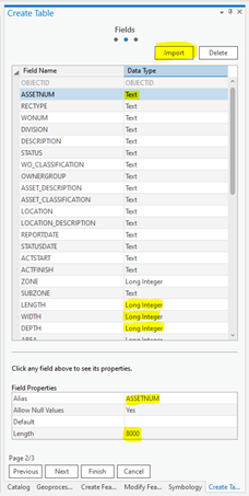

When importing a .CSV into an enterprise geodatabase as a standalone table using the Table to Geodatabase geoprocessing tool:
I want to modify the field types and field lengths. Similar to what I can do with the Create Table wizard:
