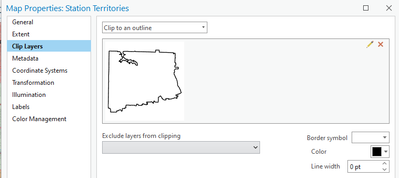

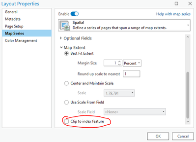

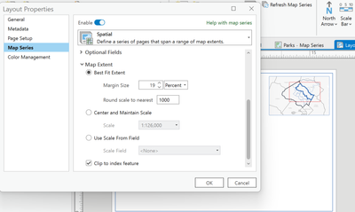

You can set to limit the map to only the extent of a specified shape within a map series, and you can also specify exceptions for displaying layers. This is set in the map properties.
Or this option can be set within the map series setting.

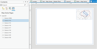

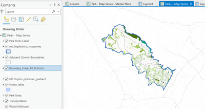

For some reason I am left with a completely blank layout in my map series now (see first image) even though the clip index is honored in the map frame from the map series selection.
C_McNamara_0-1706213066519.pngC_McNamara_1-1706213107945.pngC_McNamara_2-1706213195173.png
AubriOtis
@C_McNamara I'm not sure why your extent is going blank, that would be a great questions for the Pro Community page or to reach out to technical support  for, it could be a bug. It should work as @RPGIS explained. Clipping is the way to accomplish your workflow and has been available since ArcGIS Pro 2.x, I'm going to close this as already offered.
