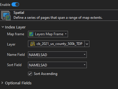

wayfaringrob
It would be nice if I could write an expression that drives the page names. Currently, you are limited to fields in your index layer:
This doesn't always get the job done, and adding a new field isn't always desirable or possible.

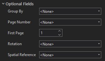

MErikReedAugusta
Right now, when you create a Map Series, you can target fields for populating certain datapoints, using the "Optional Fields" section:
I have a case, though, where my rows have a procedurally-generated tag that I'm using for sorting and other internal operations.  Within that tag, part is functionally equivalent to "Group By".
If I wanted to also group the pages according to that portion of the tag, right now it means I have to create a separate field, run a Field Calculation to rip out the Group code, and populate it into my separate field.  Then I point Map Series Group By at that separate field.
But, if I could use Arcade or Python, then not only could I pull that Group code out with two lines of code: I could also trust that it's always up-to-date.  With a separate field that I target with a Field Calculation, I have to remember to re-run that calculation anytime something might change in the data that would affect the group.
Alternately, if the Sort parameter accepted an expression, then I wouldn't even need my sort field—I could generate it on the fly from the attribute points that resulted in it.
