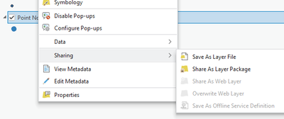

  3. Right click on map notes->Share
    1. Share as Web Layer is greyed out

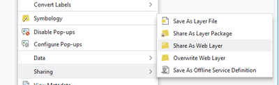

  4. Add map notes from the database as a new layer
  5. Right cick-> Share-> Share as web layer
    1. Success
