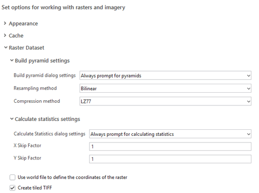

KoryKramer
@DavidVelhartický
Are the build pyramid and calculate statistics settings insufficient for you?

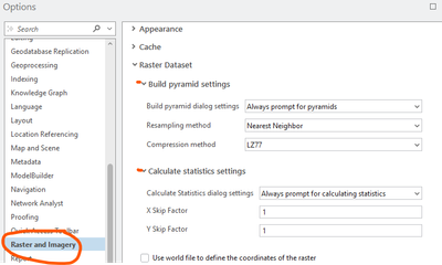

DavidVelhartický
@KoryKramer
Yes - Unbfortunately this doesn't affect settings in Geoprocessing.
Some of the Geoprocessing tools have its own settings in "Environment" - and this doesn't work with these ArcGIS Pro settings, which you show in the picture.
My settings in this section are:
But when working with rasters in Geoprocessing, it makes the "default" - automatic build of Pyramids "Nearest neighbour". And you have to set it in the Environments section of each one tool you are working with.
(And because in ArcMap I was used to take the Environment section as "don't touch it" in evry tool, now I never check this settings when using Geoprocessing.)
There was this "central setting" (your picture) in ArcMap too. But there was an other "central setting for Geoprocessing", where you were able to set some parameters for all the tools you were running from Geoprocessing section.
And I'm missing it so much now.

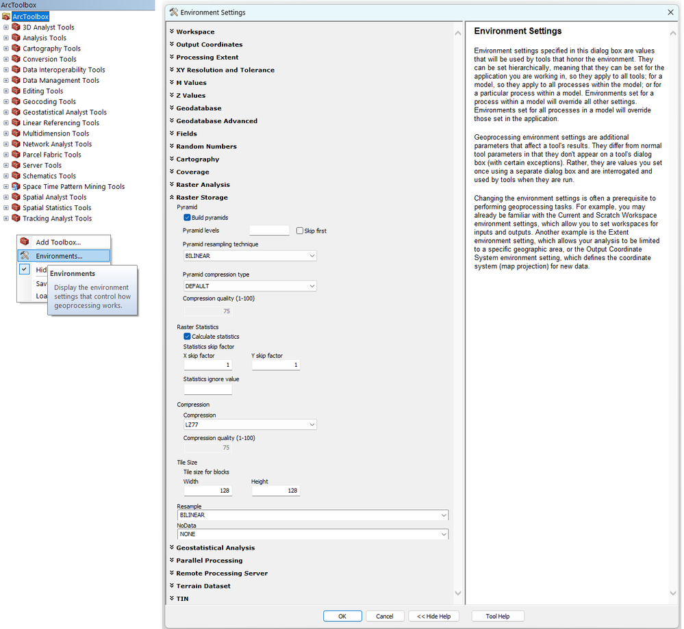

DavidVelhartický
This is what I mean:
Right click in the empty place of ArcToolbox - Environments.
...central settings for plenty of parameters used for all the ArcToolbox tools.
(Unfortunately, as I remember, there are more settings in todays ArcGIS Pro Geoprocessing tools, which heve different behaviour when you use it. Some offer for example pyramids (or other) settings and some not. Some use central settings of ArcGIS Pro or are not building pyramids at all. And you have to use separate  tool after creating the product.
Other hand, when I use some raster as source for other calculations or to send it to someone else, I don't want to create pyramids at all. But "build Nearest neighbour pyramids" is now the default of some tools and it takes the time (/storrage place) to wait till finish the creation of unwanted pyramids/statistics.)
Thank you 🙂
