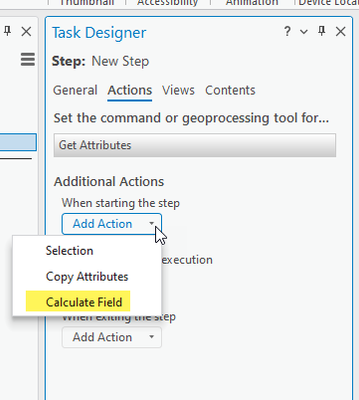

When setting up a palette with a palette-step with the action Get Attributes, it seems that "Calculate Field" (with the result of Get Attributes) is only available as an action when exiting the step. This means that the task moves to the next step (out of the palette step). The idea might be to do this within the palette.

You can set the action to calculate field when the steps starts, prior to running the command or when you exit the step.
The task behavior determines if it will proceed or not. Make sure to set it to Auto-Run or Manual.

Since I want to use the value recieved from the "Get Attributes" action when doing the calculation, the only possibility to is to use action when exiting the step; since the value does not exists neither when starting the step or prior to execution.
When adding another step to the palette, after the "Get Attributes step", the variable created in the "Get Attribute step" is not accessible. The variable is only accessible in the palette step where it's created or in the later steps outside the palette.
