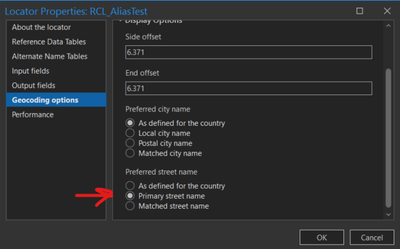

@ShanaBritt and @DanielBorden. I built a quick Street Address Role locator and linked it to an alias table and what Shana described worked. After building the locator, I set the Preferred street name to Primary street name
When I searched for an alias name, the name in the StreetAddress primary table was provided as a suggestion instead of the alias. I'm failing to think of a use case here, but providing some output fields indicating that an alias was utilized or that an alias name exists could be useful to exploit in some applications. I have not come across any output details that indicate that this alias relationship was utilized.
