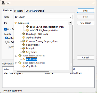

In ArcMap we had the ability to Find data within an outside Feature Service Layer from our city's GIS office for addresses.
I have this same Feature Service Layer in my ArcGIS Pro map but the Locate Tool does not show this as an optional layer for me to search from. This functionality is crucial for our workflow and should be added to the Locate Tool in Pro.

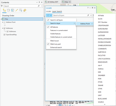

@Laura  I saw that, and I can add my own Address Point, which I have done, but I am not able to add the address feature service layer from our city's Enterprise Portal. That feature service layer isn't even available when you do a Layer Search, even though it is in my map.

@Laura I can do the same from my own Enterprise Portal, and have been been doing so with no problems. It's the feature service layer from our city's GIS portal that I can't do this with. I was able to use this same feature service layer in the Find Tool in ArcMap, and it worked perfectly fine, but it's not working in ArcGIS Pro.
You can see this in the picture below. The Address Point is a feature service layer from my Portal while the Addresses is a feature service from the city's Portal. The Addresses layer doesn't even show up as an available layer to search in. You can see in the picture from my original post above where that same Addresses layer is searchable in ArcMap.

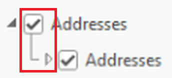

It looks like the layer is coming from a Map Image Layer (Map Service)?
By default, these are added as composite layers:
https://pro.arcgis.com/en/pro-app/3.3/help/data/services/use-map-image-layers.htm#ESRI_SECTION1_1B5A...
The UI in the screenshot shows a composite layer as indicated by the connector I have highlighted below:
I suspect  that if you add the sublayer of the Map Service as a feature layer, you should be able to get the functionality you are looking for.
