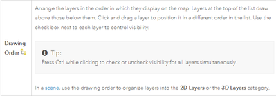

Wow, that is such a great tip! Thank you Wendy. I didn't see this here: https://pro.arcgis.com/en/pro-app/2.8/help/mapping/text/labeling-basics.htm#ESRI_SECTION1_55357542A4... or here: https://pro.arcgis.com/en/pro-app/2.8/help/mapping/map-authoring/contents-pane.htm#GUID-F85656BD-90B...
Might be a good addition, similar to this:
(Very clever people might think about trying this for other tabs in the TOC on their own, but if you only search for something specific to the labeling tab, you might not check the info under "Drawing Order" or read everything)
