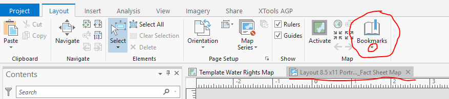

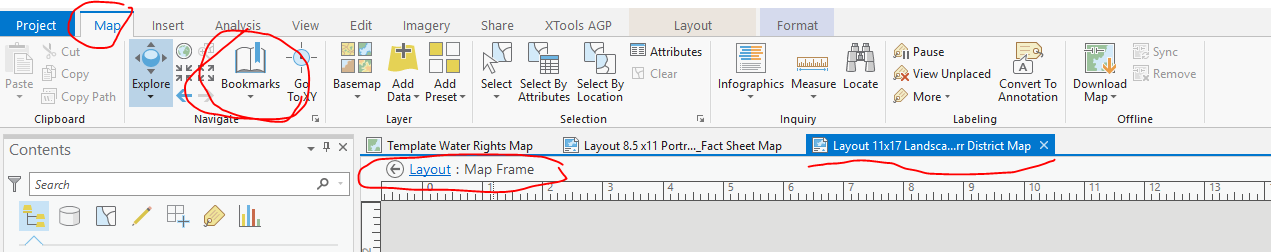

I use Bookmarks (from the Layout on the Layout Tab in ArcPro) to save a certain view. Bookmarks allow you to save multiple views for any one Layout. They are also available in Desktop versions.
If you have multiple Views within one layout, when you Activate that view (as mentioned in an earlier post) the Bookmarks for just that view are available on the Maps Tab.
Sorry for my goofy illustrations, but hopefully this will be helpful.
