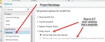

DanPatterson
By default, online help is selected in the Project Backstage.
The current version has a new offline help install.  Prior versions of Pro had their own.
