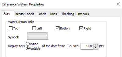

In ArcMap:
  • The ruler along the top of my layout can be in cm with mm stops (a good resolution for making maps for publication), and

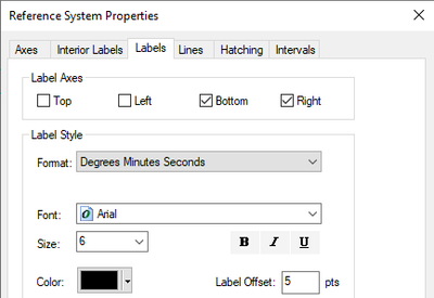

  • I can define tick length and label offset for graticules and grids in points (handy when making really fine maps).

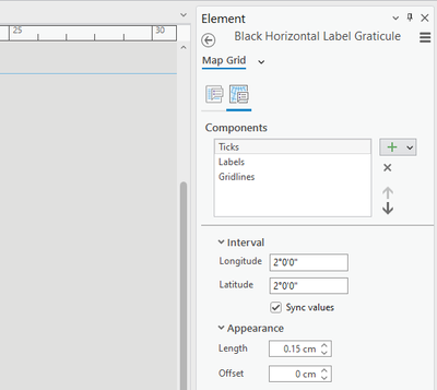

In ArcGIS Pro:
  • While I can set the page units to be centimetres to achieve a helpful ruler for my layout,
  • I don't seem to be able to define tick length and label offset for graticules and grids in points, only centimetres.  This does not give me the fine resolution I need.

ArcGIS Pro grid settings like tick length use cmArcGIS Pro grid settings like tick length use cm
ArcMap grid settings like tick length use ptsArcMap grid settings like tick length use pts
ArcMap grid label offset setting uses ptsArcMap grid label offset setting uses pts

JesseWickizer
The tick length, tick offset, and label offset for graticules and grids use the page units defined in the layout's ruler. If you want to set the tick length in points, first change the ruler units to points by right-clicking the ruler and choose Ruler Properties.
geodoozer
Thanks, that'll work.  I see the value is held, even when I change the ruler back again.  I still like the idea of having the option to enter the units along with measurements into dialogues, so users can use whatever best works for their situation, but I like that Pro does let me work in pt and cm or mm.  Thanks.
