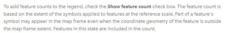

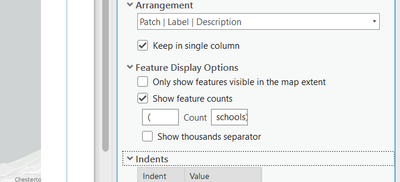

This capability is already present.  The "Show feature count" does show the count for only features visible in the map frame.  Here is the tooltip for the option:

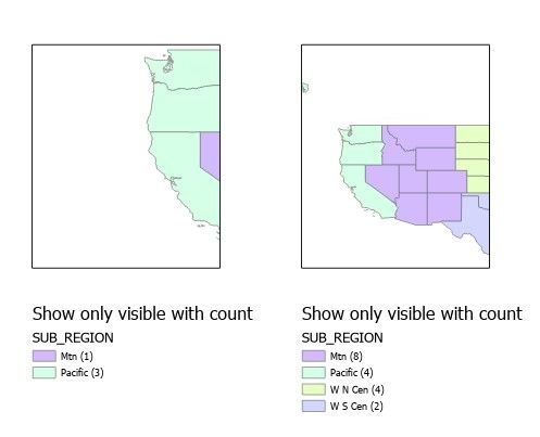

Here is an example of the results with a simply polygon layer symbolized with unique values.
An important caveat is that the count is based on the features symbol and not on its geometry as stated in the help "Work with a legend item".

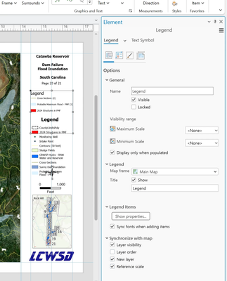

MichaelMarcus

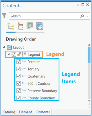

Where is this wonderful little gem of a tool located?  It does not appear in the legends element panel.
AubriOtis
AubriOtis
@MichaelMarcus it's in the properties for the legend item, not the legend itself. It looks like you are looking at the legend properties. If you select one or more legend items, you should see the option.
MichaelMarcus
@AubriOtis, Thanks a lot, that did it.
