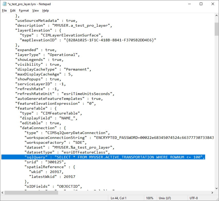

  1. If I open a .lyrx file in a text editor, the source code is in JSON format and is human-readable.
    • The definition query SQL expression is human-readable in the file too.
  2. An EGDB query layer can be saved as a .lyrx file. The full query (SELECT/FROM/WHERE/ETC.) is human-readable in a text editor.

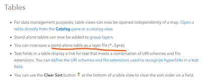

  3. In Pro 3.1 (not 2.6.8), .lyrx files seem to support standalone tables too, not just layers, which is good.
Do you agree that .LYRX files do everything we need (at least in Pro 3.1)?

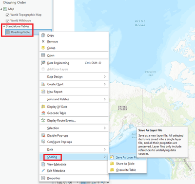

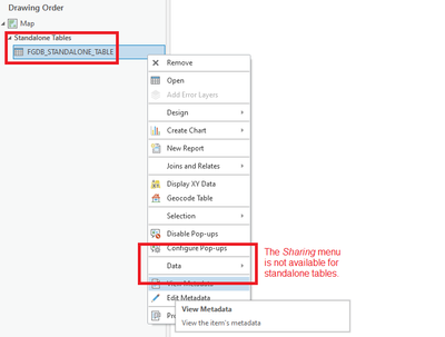

If I understand correctly, somewhere between ArcGIS Pro 2.6.8 and 3.1, functionality was added so that .LYRX files can be created for standalone tables, not just layers.
If that's the case, then I think this idea can be closed. Thanks.
ArcGIS Pro 2.6.8:
ArcGIS Pro 3.1:
