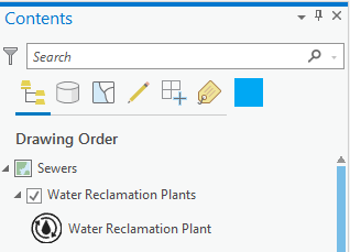

NathanHeickLACSD
Well, I just looked at ArcGIS Pro and asked myself where I would look to find this information and I think the Contents Pane would be the natural place for it.  For example, another icon to the right of the label icon where the layers can be listed in drawing order or in order of layer ID.

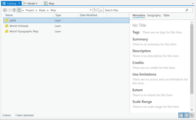

NathanHeickLACSD
Honestly, I'm just realizing that there is a lot of map functionality on the Catalog View, like updating data sources.  I think that is consistent with ArcMap.  However, it's not my natural instinct to go to the Catalog View to see the layer IDs of a map.  That would not be my preference.

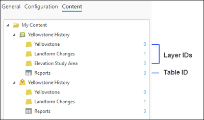

TanuHoque
@NathanHeickLACSD
We enhanced the Sharing pane in ArcGIS Pro 3.1 release to show layer-ids. Please see this screenshot..
Please see the idea that Kory added above - against which the enhancement was made. We hope this will help with your workflow, otherwise please let us know.
