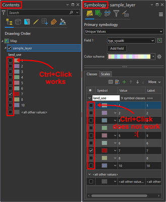

Hi everyone,
This is a very simple idea. According to this page, it is possible to use these 4 keyboard shortcuts on the checkboxes in the Contents Pane:
Ctrl and click a check box
Turn on or off all selected items. If a single item is selected, all items at the selected hierarchical level are turned off.
Ctrl+Shift and click a check box
Turn on or off all selected items. If a single item is selected, turn on or off all items at all hierarchical levels.
Alt and click a check box
Turn off all layers except the one whose check box you clicked at the current hierarchical level.
Alt+Shift and click a check box
Turn off all layers except the one whose check box you clicked at all hierarchical levels, including group layer contents.
What I suggest is to extend this behavior (4 shortcuts) to the Unique Values symbology table (see image).
That's all.
