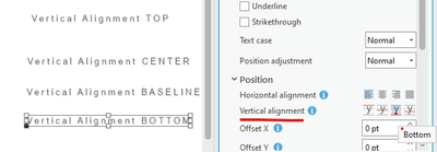

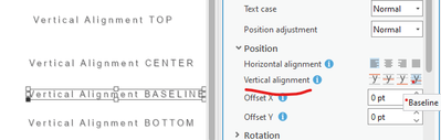

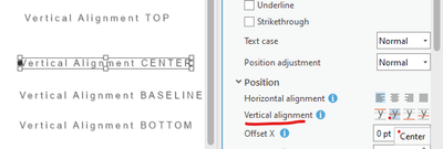

I imported an mxd into Pro 3.3 using the various vertical alignment options and I see the property maintained:

Center:
Baseline:
Bottom:

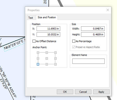

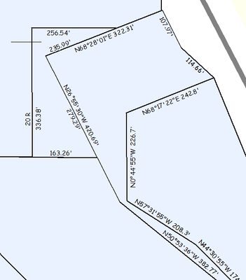

Here are two screenshots of the before labels (ArcMap 10.8.2) showing original label placement and properties.

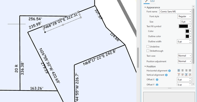

And here is a screenshot of the label placement in ArcPro 3.2.1GISMapLady_2-1722274836648.png
When I change the vertical alignment to middle, then the placement is corrected. Funny enough, when I set the vertical alignment to top, the text will move to the bottom of the outlined box.

As I shared in our email thread, for some specific layout text examples with specific rotation applied, the Compatibility Mode option needs to be refined. Turning that off for the problematic text elements should resolve the issue and the development team will create an issue to improve the behavior.
