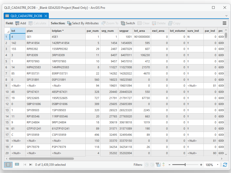

In case there is still a misunderstanding of what I mean with Attribute Table, it is this thing:
