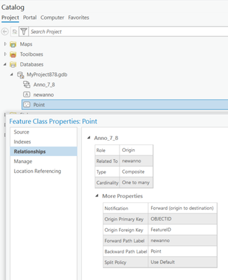

If I understand correctly, there isn't a way to see if a point/line/polygon FC has an annotation FC associated with it -- via the point/line/polygon FC's Catalog properties.
Could that functionality be added?
1 Comment
WendyHarrison
You can see if there is a feature-linked annotation feature class in the feature class properties.
It is under the relationships tab
