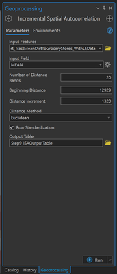

In recent versions (currently observing on 3.3.0), Esri has removed functionality of the Incremental Spatial Autocorrelation tool. It used to spit out a PDF containing a Global Moran's I table and chart. Now, this is only available in a database table or the messages, which I find quite clunky and less useful than the standalone report. Copying/pasting values from the table in messages is especially maddening (what do you mean "copy all?")
In addition, Esri's own documentation still mentions the PDF output: https://pro.arcgis.com/en/pro-app/3.3/tool-reference/spatial-statistics/incremental-spatial-autocorr...
But this parameter is missing from the GP tool.
Further--and I understand this is a niche use case--I would like to have students submit this file with their homework. The "improved" method makes this all harder.
Please restore the PDF output from this tool. Thank you!

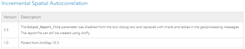

The parameter was intentionally removed from the UI due to the limitations associated with the PDF report generated by the python library matplotlib. This library has compatibility issues with certain languages and newer windows operating systems, which can result in missing fonts and consequently an empty PDF. In summary, relying on this method is not a sustainable solution to ensure the PDF report works effectively for all users. Instead, the new charts and geoprocessing messages are more standard and recommended ways to access the information. However, you can still create reports using arcpy. If you run the tool using arcpy, you can still access the PDF output parameter.
Since the parameter is there in arcpy, the documentation still has it. It is only hidden from the UI to encourage the use of charts and geoprocessing messages. We have also now added a note about it in the toolbox history for the next release.

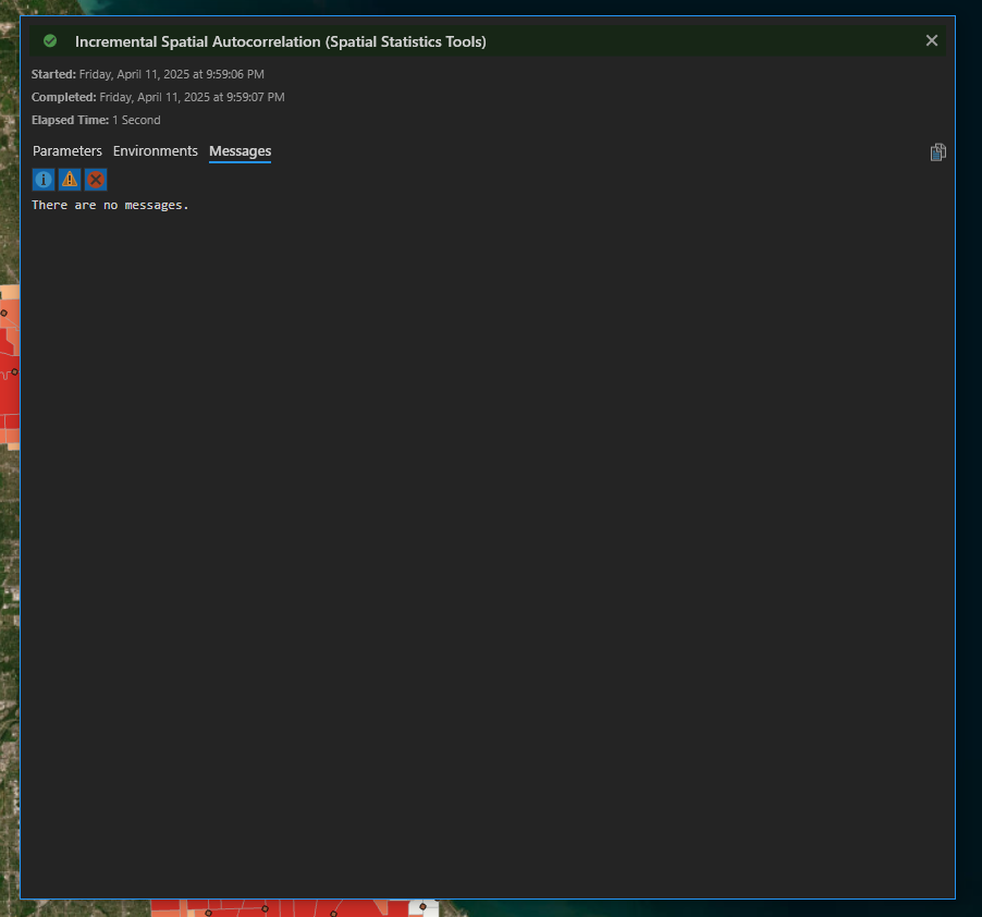

wayfaringrob
@AnkitaBakshi  - what do you suggest when the messages window does not display the chart as you described?
