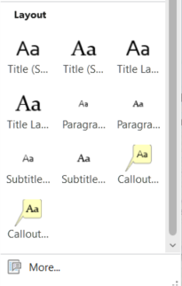

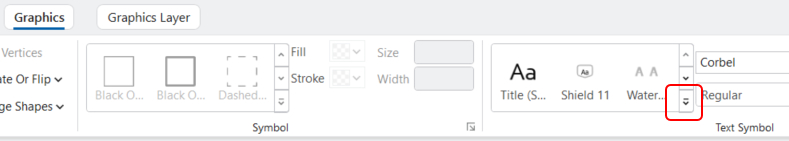

There is a pre-defined yellow balloon callout style that comes installed with ArcGIS Pro that's accessible from the Graphics ribbon, Text Symbol group, in the Text Symbol gallery.
Click the More button in the lower right of the gallery and scroll down to find various styles including a yellow balloon callout.

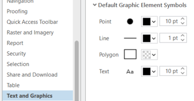

Newly-added graphics inserted from that menu use the symbol styles configured in the Text and Graphics section of the ArcGIS Pro Options menu.
You could configure the Text graphic style to use a callout so that all newly created text graphics use that style.
