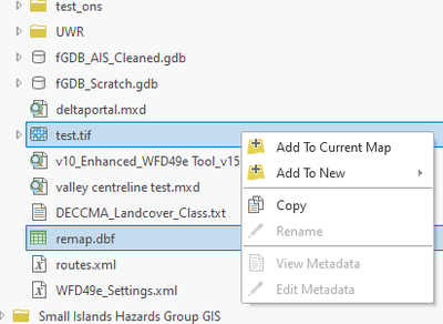

In ArcGIS pro 2.9 if you select several datasets  in the Catalog pane and right click the Delete option is missing from the context menu when the data types are different. An example is shown below.
Where's the delete option?

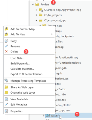

If I had selected multiple datasets of the same type, e.g. tif files, then when I right click I see the Delete option.

Yeah but if you have several datasets selected which are of different types then the Delete option does not appear.  I often want to clear out my temp folder; I might select a few shapefiles, dbf and rasters that have been generated through intermediate steps and I want to delete the lot in one go.

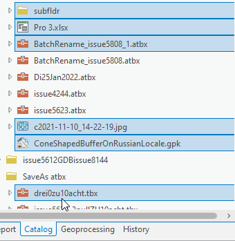

just in case you're not aware that--while not from the context menu--you can delete multiple data elements of different types using the Delete tool.
Ensure you have the Delete tool open on the Geoprocessing pane
With the selection active on the Catalog pane
drag the cursor onto the Geoprocessing tab

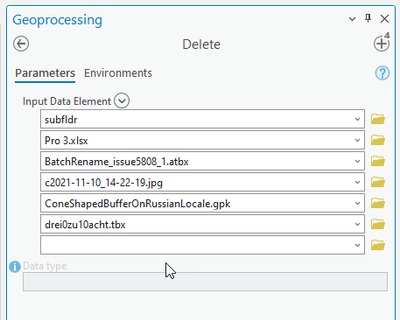

once it opened, drop the selection onto the Delete tool's Input Data Element
and run the tool.
Granted, that's a couple of moves/clicks more, still better than deleting them one-by-one.

The problem case mentioned in this idea thread about not being able to delete a raster dataset together with items of some other types - this is actually a bug, and has been fixed in ArcGIS Pro 3.0.  ArcGIS Pro does allow deleting items of different types as long as all these items allow being deleted individually.  Any other similar problem cases would also be due to a bug of the same nature and need to be reported to the Technical Support.
