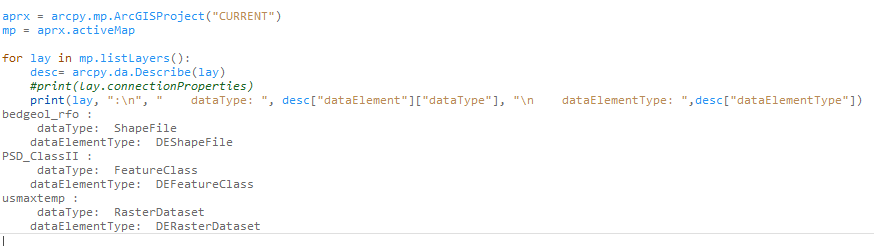

5.
Layer properties—ArcGIS Pro | Documentation I checked dataElementType and dataType. Neither are formatted correctly, so I would need to build a dictionary to match to the (missing) comprehensive list.

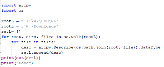

I thought I might be able to make a list by just describing every file in a directory, then returning the set, but surprise: any coverages will crash both Pro and ArcMap (To be clear, I'm not planning on using coverages, but we do have some and they're getting in the way of trying to get this list).
This will crash Pro and ArcMap/Catalog when it reaches a coverage. Changing to arcpy.da.Describe() for Pro doesn’t help.

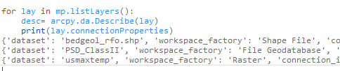

        layCP = lay.connectionProperties
        fCP = {'dataset': descR["name"],
               'workspace_factory': wkspfactDict[descR["dataElementType"]],
               'connection_info':
              {'database': descR["path"]}
        lay.updateConnectionProperties(layCP, fCP )
print("done")
