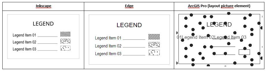

When loading svg file into layout of ArcGIS Pro project (as Picture element), there are several issues.
If the svg contains Pattern fill or the tag <tspan>, then it's corrupted, as can be seen on the attached image.
 The svg shown on images above:

Jakub

Hi Jakub,
Our team is taking a look at this. Thanks for reporting it!

AubriOtis
Status changed to: Implemented
This is available in ArcGIS Pro 3.5.
