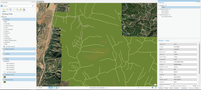

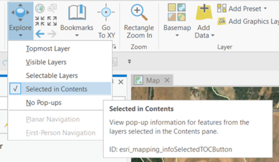

It's not quite an identify vector features only option, but in ArcGIS Pro you can set the Explore tool to work only on layers 'Selected in Contents'

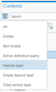

Filter the Contents to show only Feature Layers
Select the first layer, Shift + click the last layer and the explore tool will include everything except imagery.
