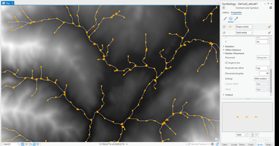

You could run the https://pro.arcgis.com/en/pro-app/latest/tool-reference/spatial-analyst/derive-stream-as-line.htm tool on your DEM to give you the flow lines. If the ultimate goal is for something like flood modeling, note that in the ArcGIS Pro Roadmap we have "simulation modeling" -Simulate complex phenomena like airflow and fluid dynamics in 3D/4D based on physical models. This of course will go far beyond dropping a point on a map to show the direction water would flow at a single point.
Here's a quick example of running the Derive Stream as Line tool and symbolizing the output lines with arrow markers. Maybe that helps?
