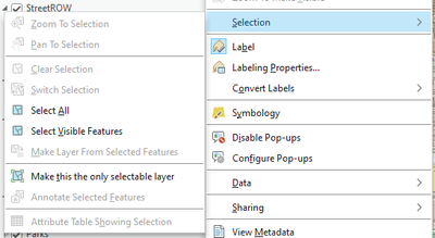

Currently, the only way to filter out geometry for labeling is to
1) create a SQL query based on an attribute
2) set a limit for minimum feature size
both of these are helpful to a point, however, it can be difficult to add a large number of geometries not to be labeled with SQL query if they do not have attributes in common (e.g. individual house numbers). It would be great if there were the option to "Turn off labeling for selected features" that would automatically be added to the SQL query.
This would be a great fit in the selection pane below "Annotate Selected Features".  This is a great option for turning off mass amounts of labels at once without having to edit the SQL query manually, and who want to retain the geometry having a label and NOT an annotation.
