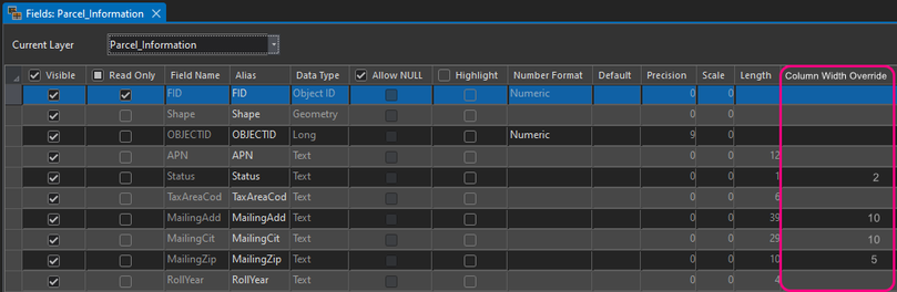

Provide a "manual" override for column width in ArcGIS Pro map layer attribute tables which persists and lives with the layer. Click-and-dragging the right side of an attribute column would continue to be the primary method for manually overriding the column widths, but those overrides should be stored and optionally controlled in the "Fields" data design view, like so:
These settings would be saved with the map/table layer, so that they persist from session to session, and migrate along with the layer if it is saved out and shared.
