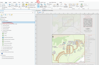

I noticed that if you are in an activated map via a Layout you are unable to get to the graphic options. This makes it so you are unable to select or modify graphics from layout mode. It would be useful if this was accessible from layout as I'm generally doing my editing for a layout from there. I am on version 3.3.1
Layout - Activated (No way to Access Graphics Options)
Regular Map view, able to get to Graphics

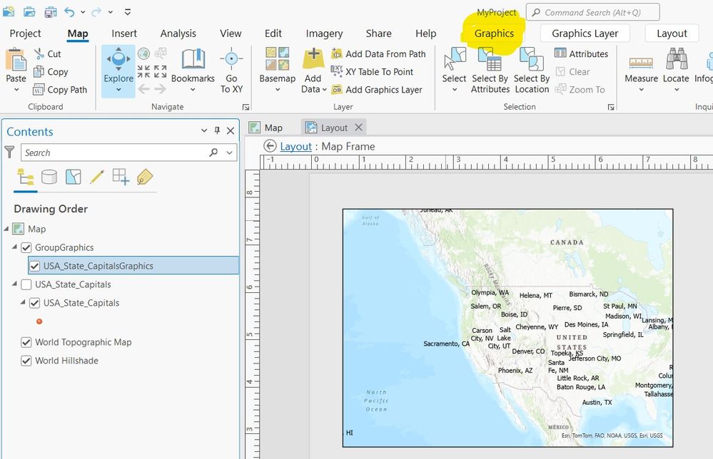

Hi @BrettFrahm
I believe what you are seeing is a bug. Accessing the graphics in an activated map frame is already available.  Here is a screenshot I took using 3.3.1.
The problem you are running into may be specific to your data/workflow. Can you contact Esri Support? They are better equipped to handle troubleshooting steps and gather bug data. They can be contacted at https://support.esri.com/en/contact-tech-support.
