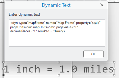

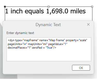

This is available in ArcGIS Pro. You just add the zeroPad = "True" tag to your existing tag. By default when rounding if the decimal is 0 it doesn't show. Adding zeroPad = "True" forces the decimal to display.
BUG-000141745 is as designed, but only because it referenced map series attribute dynamic text which points to a field. The field could be numeric or text values, resulting in some rounding limitations.
In your case, you are using Scale dynamic text which always returns a numeric value, supporting more rounding and decimal options.

@AlfredBaldenweck  true it does not help with that. However in the original issue it said "acceptable outputs might include "1 inch = 1.0 miles"  (adding an additional decimal place) or "1 inch = 1 mile" (dropping the "s").". We can do the first acceptable solution already in the software.
