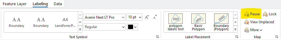

JesseWickizer
The Map and Labeling ribbons include a Pause labeling button that stops labeling but still allows the layers to draw.
