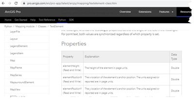

I need to be able to get and set the anchor points of layout elements in ArcPy. Currently, it is impossible for arcpy to know whether the layout elements of any given MapDocument are on or off the layout. You can access the XY positions of the elements, but these are in relation to their anchor point which could be different for each element. This would be very helpful for map automation scripts, as I currently have to make separate versions of my scripts for MXDs that have slightly different layout elements or page sizes.

Starting with Pro 2.5, this can be accomplished using Python CIM Access
https://pro.arcgis.com/en/pro-app/latest/arcpy/mapping/python-cim-access.htm
Here is a simple snippet:
p = arcpy.mp.ArcGISProject('current')
lyt = p.listLayouts()[0]
lyt_cim = lyt.getDefinition('V3')
for e in lyt_cim.elements:
   if e.name == 'Rectangle':
       print(elm.anchor)
###BottomLeftCorner
