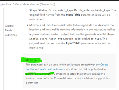

Is the Minimal Output Fields option in the Geocode Addresses or Geocode Table tools not working for your workflow? You need to have ArcGIS Pro 2.7 or later, a locator created with the Create Locator tool or Create Feature locator tool and if its a service it needs to be on Enterprise 10.9.
The note at the top of the following topic describes what is added to the geocode result and the fields that are returned with the various Output Fields parameter option. https://pro.arcgis.com/en/pro-app/latest/help/data/geocoding/what-is-included-in-the-geocoded-result...

@jlchamber Based on the following description, what about the fields that are returned presents a problem for you? Does 'Location Only' work for your workflow?
"Minimal returns following fields that describe the location and how well it matches information in the locator in the geocode results: ShapeStatusScoreMatch_typeMatch_addr, and Addr_type. The original field names from the input address table are maintained."
Location Only returns the Shape field plus the original field names from the input address table.

I think I'm still having this issue because our county's ArcGIS Server is still at 10.81 and my Pro version is still 3.03 due to a different compatibility issue with the server.

@AZendel , correct you need Enterprise 10.9 or later to use the Minimal option in the optional Output Fields parameter.
